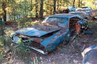

A mere 22 years later, Travis Bell and Gary Schneider, who had founded and were co-presidents of the North American General Lee Fan Club , went looking for Dukes artifacts in Georgia while on tour with " The Dukes of Hazzard Reunion Tour 2000." A peine 22 ans plus tard, Travis Bell et Gary Schneider, qui avait fondé et co-présidents de l'Amérique du Nord, le général Lee Fan Club, a la recherche d'artefacts Dukes en Géorgie en tournée avec "The Dukes of Hazzard Reunion Tour 2000." Through conversations with the series' old transportation coordinator, Bell and Schneider eventually wound up at Cliff Shaw Transmissions in Dawsonville. Grâce à la série de conversations avec les "anciens coordonnateurs de transport, Bell et Schneider finalement liquidée à Cliff Shaw Transmissions en Dawsonville.
"They had 51 totaled vehicles and the show hadn't even aired yet," remembers Bell. "Ils ont totalisé 51 véhicules, et le spectacle n'a même pas encore diffusé," se souvient de Bell. "Don Schisler, the transportation coordinator, gave them all to Cliff Shaw in exchange for two transmission jobs. Shaw crushed all of them...except those that had concrete in their trunk." "Don Schisler, le coordonnateur du transport, a donné à tous de Cliff Shaw en échange de deux réseaux de transport d'emplois. Shaw écrasé tous les ... sauf ceux qui ont dans leur coffre de béton."
Back in 1978, state-of-the-art Dodge Charger aviation involved filling the trunks with concrete in order to balance the weight of the engine and keep the cars from immediately nosing over during their brief, almost always terminal but also glorious, flights. Retour en 1978, state-of-the-art Dodge Charger aviation impliqués combler les troncs avec du béton afin d'équilibrer le poids du moteur et de garder le nez de marche des voitures de suite au cours de leur bref, presque toujours administration, mais aussi glorieux, vols. "And," Bell says, "[Shaw] said that he still had the vehicles with concrete in their trunks on his property [that contains hundreds of junked cars]. He said to just go down to the Pinto and turn left." «Et», Bell a déclaré: «[Shaw] a dit qu'il avait encore les véhicules avec du béton dans leurs malles sur sa propriété [qui contient des centaines de voitures ferraillés]. Il a dit à juste aller à la Pinto et tourner à gauche."
Back home again in Indiana Retour à l'accueil de nouveau dans l'Indiana

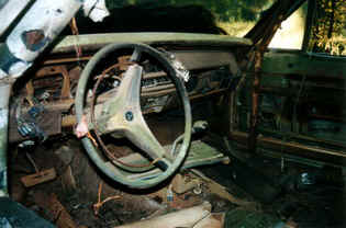

When Bell followed those directions through Shaw's backwoods, he found the first General Lee — mangled, derelict and sinking into the Georgia clay. Lorsque Bell a suivi ces directives par le biais de Shaw backwoods, il a trouvé la première General Lee - torturé, à l'abandon et le naufrage de la Géorgie dans l'argile. A year later Bell went back, paid a reasonable three-figure sum, put the first General Lee on a trailer and took it back to his home in Indianapolis. Un an plus tard, Bell retourna, payé un montant à trois chiffres, mettre la première General Lee sur une remorque et a pris de nouveau à son domicile, à Indianapolis.
"I had the car for two years," Bell explains. «J'ai eu la voiture pour deux ans", explique Bell. "In its totaled state I took it to Chryslers at Carlisle and a few other shows. But people kept taking 'souvenirs' off it; paint chips and such. It was becoming a pain to babysit. So I sold it on eBay for $20,400 to four gentlemen in Ohio. And pretty soon they realized that once you have it, what do you do with it? So they put it back up on eBay and sold it to Marvin Murphy in Florida for $30,000. «Dans son état, j'ai totalisé à Chrysler à Carlisle et quelques autres spectacles. Mais les gens maintenus en tenant« souvenirs »de lui, et ces éclats de peinture. Il est de plus difficile à garder. Alors, je l'ai vendue sur eBay pour $ 20.400 à quatre messieurs en Ohio. Et très vite ils ont compris qu'une fois que vous avez, qu'est-ce que vous en faire? Alors, ils ont mis de nouveau sur eBay et vendu à Marvin Murphy en Floride pour $ 30,000.
"I drove with Marvin to Ohio, and we brought it back to my house. I asked Marvin what he planned to do with it. He said 'Now, we rebuild it!' «J'ai roulé avec Marvin en Ohio, et nous a fait revenir à ma maison. Marvin j'ai demandé ce qu'il a prévu de faire avec lui. Il a dit:« Maintenant, nous reconstruire! I told him I thought it would be easier to pull the VIN off and put it on another car. 'You will never be able to fix this car,' I told him. 'I have no desire to rebuild this car.' Je lui ai dit que je pensais qu'il serait plus facile de tirer la VIN décollage et le mettre sur une autre voiture. «Vous ne serez jamais capable de fixer cette voiture, je lui ai dit." Je n'ai aucune envie de reconstruire cette voiture. " And then he said to me, 'Travis, if someone spray-painted the Mona Lisa, someone would have to restore it. You're that man.' Et puis il m'a dit: "Travis, si quelqu'un peints de la Mona Lisa, il faudrait restaurer. Vous êtes l'homme". How could I argue with that?" Comment peut-on s'opposer à cela? "
Saving the unsalvageable Sauver la unsalvageable
So Bell began disassembling the car and sending the various pieces around Indiana for resurrection. Ainsi, Bell a commencé à démonter la voiture et de l'envoi des différentes pièces autour de l'Indiana pour la résurrection. The original engine and transmission were rebuilt at Jim's Auto in Greenwood, Indiana, and the shell was dropped off at Duane Walters at Walters Body Shop. L'origine du moteur et la transmission ont été reconstruites à Jim's Auto à Greenwood, Indiana, et le réservoir a été déposé à Duane Walters Walters au Body Shop.
"If you put the car under a black light you could see the General Lee underneath," explains Bell. "Si vous mettez la voiture dans le cadre d'une lumière noire, on pouvait voir en dessous de la General Lee", explique Bell. "So [pinstriper] Bob Keeney and I sanded all the green off the top to see underneath it. Took measurements and drawings and got all that down. Then we sent the shell for sandblasting and put it on the rotisserie. The transmission tunnel was folded over, and the whole car was shortened an inch to an inch and a half. It was bent, but solid. No rust. The Georgia clay had saved it." «Alors, [pinstriper] Bob Keeney et j'ai poncé tous les verts de la page pour voir en dessous. A pris des mesures et des dessins et tout ce qui a down. Ensuite, nous avons envoyé la coquille de sable et de le mettre sur la rôtissoire. Le tunnel de transmission a été pliée de plus, et tout le wagon a été raccourcie d'un pouce à un pouce et demi. Il a été plié, mais solide. Pas de rouille. argile La Géorgie a sauvé. "
On a frame rack the car near miraculously pulled out to almost perfect Dodge factory specifications. Sur un châssis rack à proximité de la voiture miraculeusement sorti presque parfait Dodge usine spécifications. "So there's no replaced frame and even that hump in the tunnel pulled out. But the whole back of the car needed to be replaced, so I bought another '69 Charger and took the whole rear clip and put it on Lee 1. The only repro sheet metal is the truck floorpan. The doors and the fenders mounted straight up." "Il n'ya donc pas de remplacer ce même cadre et bosse dans le tunnel, se sont retirés. Mais tout le retour de la voiture devait être remplacé, de sorte que j'ai acheté un autre Charger'69 et a pris tout le clip de l'arrière et de le mettre sur Lee 1. La seule repro tôle est plancher du camion. Les portes et les ailes montées à la verticale. "
